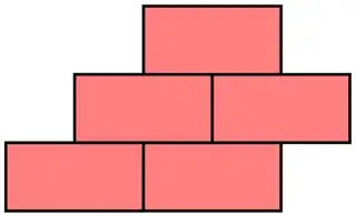

Clearly, a stack of bricks that does not have any "overhangs" should be stable:
Stack without overhangs

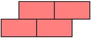

But we can also allow a cantilever if there's a brick above:
Valid cantilever

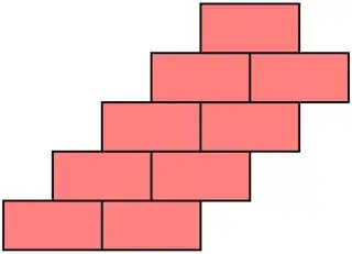

However, having a brick above is not sufficient, because a stack like this should not be stable.
Invalid cantilever

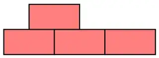

Similarly, having a brick above is necessary because a configuration like this is in unstable equilibrium; in particular the upper-right brick in this example would fall if an arbitrarily small force were applied to the right side.
Unstable equilibrium
