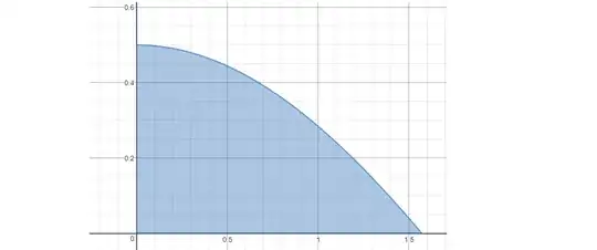

The function under the integral is very nice in the range of interest and looks like this:
