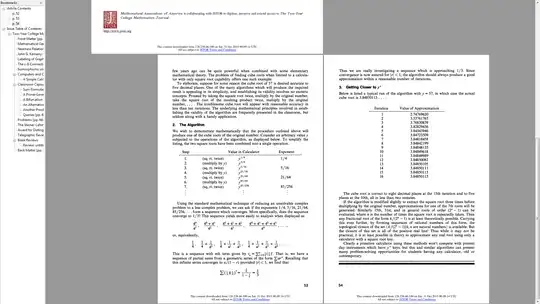

It is given in the paper titled: A Simple Calculator Algorithm by: Lyle Cook, James McWilliam; the way to iteratively find using the cube root using the square root operation is to perform the set of two operations alternatively: (i) Take the square root twice; (ii) multiply by the original number, ...
I want to know first why this approach is deemed useful, i.e. on what basis. It is also stated on the last page(#54) that a better way is to take the square root thrice, instead of twice. So, what is the reason for taking $y^\frac{1}{2\sqrt 2}$. (sorry, if not represented root properly, request correct way then)
Second, I tried to find the value obtained by program, by giving inputs : $57, 24, 8$. Request suggestions for improvements.

As explained in the paper, it is based on the infinite sum of geometric progression: $\sum_1^\infty(1/4)^n=1/3$. The number that you get after taking square root twice at each iteration is an approximation of the cubic root. I am not sure why they are suggesting to take the square root thrice, I do not think it's going to be an improvement.

Starting from $x_1=r$,
Define:
$$x_{k+1} =(x_k+1)r$$
We can easily prove by induction that this is just a geometric series with the first term being $r$ and common ratio $r$,$$x_{k+1}= \sum_{i=1}^{k+1}r^i=\frac{r(1-r^{k+1})}{1-r}$$
Hence as $k \to \infty$, if $|r|<1, r \ne 0$, $$x_{k+1} \to \frac{r}{1-r}=\frac{1}{\frac1r-1}$$
If we pick $r= \frac14$, then the sequence converges to $\frac1{4-1}=\frac13$.
If we pick $r = \frac1{2^n}$, then the sequence converges to $\frac1{2^n-1}$
and we have $y^{x_k} \to y^{(\frac1r-1)^{-1}}.$ If we pick $r = \frac14$, then $y^{x_k} \to y^\frac13$.
Taking square root twice means $\frac14$ at the power indices and multiply by itself once means plus $1$ in the power index.

    If you take square root two times and multiply by $y$, repeat the procedure, you are trying to estimate $y^\frac13$. If you take square root $3$ times, and multiply by $y$, repeat the procedure, you are trying to estimate $y^\frac17$. The two procedure are estimating different things. – Siong Thye Goh Apr 04 '18 at 04:40
  • So, the paper is hinting by the third power of square root something achieving the result, but without any logical basis. – jiten Apr 04 '18 at 04:44
    "huh, without logical basis?", the paper is using geometric series as shown in the lower left of the picture. – Siong Thye Goh Apr 04 '18 at 04:48
  • Thanks a lot, will read more carefully in future. I am sorry, but may be due to seeing such paper after a very long time am getting errors in comprehension. Actually, the second method is for $7$th root. It is error due to reading carelessly. – jiten Apr 04 '18 at 04:53
