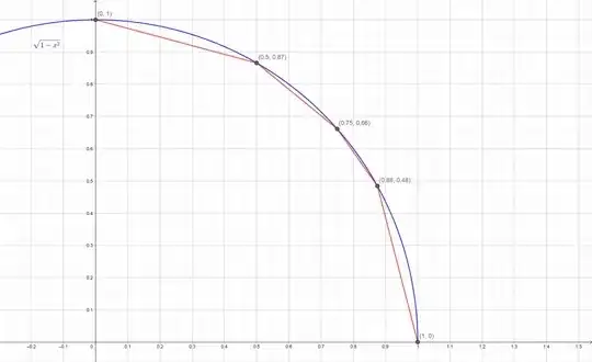

Let $f(t) = \sqrt{1-t^2}$. Since $f$ is even $$ 2 \int_{-1}^{1} f(t)\,dt = 4 \int_{0}^{1} f(t)\,dt $$
Bound $f$ from below with easily integrable functions, like straight lines. For example, in this case, the concatenation of the line segments connecting in order the points $(0, f(0))$, $\left(\frac{1}{2}, f(\frac{1}{2})\right)$, $\left(\frac{1}{2} + \frac{1}{4}, f(\frac{1}{2} + \frac{1}{4})\right)$, $\left(\frac{1}{2} + \frac{1}{4} + \frac{1}{8}, f(\frac{1}{2} + \frac{1}{4} + \frac{1}{8})\right)$ and $(1, f(1))$ is sufficient.
approximation by lines below
Let $L(t)$ the concatenation of these lines. Show that $3 < 4 \int_{0}^{1} L(t)\,dt$ and $L(t) \le f(t)$ for $t \in [0,1]$. Then conclude by the integral monotonicity that $$ 3 < 4 \int_{0}^{1} L(t)\,dt \le 4 \int_{0}^{1} f(t)\,dt $$
Actually you can partition the interval the way you prefer and with enough line segments you will be able to conclude the same.

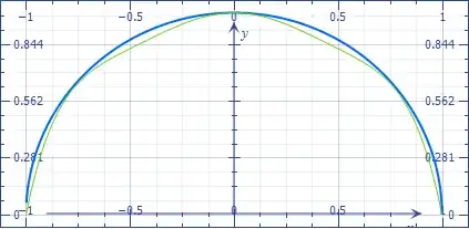

Hint:
It can be shown rigorously that
$$\sqrt{1-t^2}\ge 1-t^2+\frac{t^4(1-t^2)}{0.65}$$
and the integral of the polynomial is $\frac{412}{273}>\frac32$.
    Interesting, what was your approach to come up with said polynomial? – Marko A. Rodríguez Mar 30 '18 at 18:06
    @MarkoA.Rodríguez: empirical. I looked at the shape of $\sqrt{1-t^2}-(1-t^2)$ and found a polynomial that fitted. [$1-t^2$ alone is not enough, it lead to a ratio $4/3$, so you need to find extra terms.] –  Mar 30 '18 at 18:33
