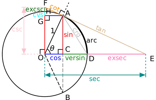

There are a lot of trigonometric functions which are defined geometrically, which we rarely use anymore. Many of these are summarized by this image:
All the trigs!  Original source: https://blogs.scientificamerican.com/roots-of-unity/10-secret-trig-functions-your-math-teachers-never-taught-you/
These all have their uses in particular circumstances. For example, the half versed sine (or haversine) is useful for determining the great circle distance between points, which is incredibly useful if you are trying to navigate. We don't need the haversin, but it is useful, and reduces notation a bit in at least one specific context. The other trig functions are similar—personally, I would rather write $$ \frac{\mathrm{d}}{\mathrm{d}t} \tan(t) = \sec(t)^2 $$ than $$ \frac{\mathrm{d}}{\mathrm{d}t} \frac{\sin(t)}{\cos(t)} = \frac{1}{\cos(t)^2}. $$
EDIT: This answer was written when the question seemed to be asking about the "necessity" defining secant and cotangent functions. It seems that the original questioner had a much more general question in mind, i.e. why do we need any definitions at all? The only possible response that that, I think, is because mathematics would be impossible without "definitions." Working under the assumption that the original questioner is in earnest, a partial answer is as follows:
