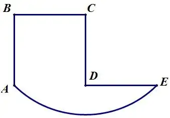

Is it possible to cut this shape:
into 2 congruent parts (equal area and shape).
The guy who gave us this teaser said that it's possible. But i can't for the life of me figure out how.

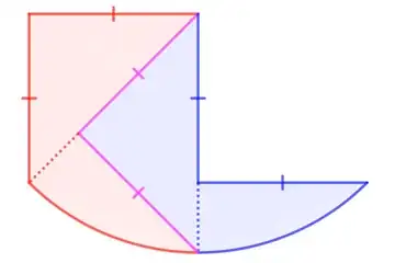

In the figure, $ABCD$ is a square, angle $CDE$ is a right angle, and the curve $AE$ is a circular arc with center $C$.
