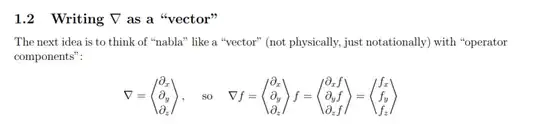

Now from the document How do the $\nabla x$ and $\nabla \cdot$ notations work?:
Enter image description here
Currently I interpret the nabla symbol as a way of turning something into a vector. Is my understanding correct?
Anyway, what is the meaning of it, and why is it used? (Please try and describe it as simple as possible.)
Less important
In case there should exist multiple meanings of this symbol, this is the context: I stumbled upon this symbol when researching neural networks (C denotes the cost function):
"-∇C(...)= [*this is a vector of weights and biases*]" (source)

    Nabla is a cute way of writing down some vector calculus derivatives in a way that is easy to remember. If you are interested in $\nabla f$ for some function $f$ however, you should look up what the "grad" derivative is. – Joppy Mar 27 '18 at 13:50
  • @AndrewLi "containing operators", does that mean that it it's not capable of containing eg just numbers? Anyway see this video, this is where i stumpled upon the nabla symbol: https://youtu.be/Ilg3gGewQ5U?t=1m31s I also wrote a comment in the comment section: ""1:31 What does that "nabla" symbol indicate? Why don't you just write "-C(...)""" – Sebastian Nielsen Mar 27 '18 at 13:50
    $\nabla$ isn't a thing in the same way that $\frac d{dx}$ isn't a thing. By itself, it means nothing and that someone made a typo. But in combination with a function, then it means something. – Teepeemm Mar 27 '18 at 15:22

Nabla is a vector whose components are operators. In the three-dimensional case you quote, $\nabla=(\partial_x,\partial_y,\partial_z)$. It is not a vector in the usual sense (of vectors in $\mathbb R^3$), but it is a very convenient abuse of notation.
The example given in the question gives a convenient way to write the gradient of a function $f:\mathbb R^3\to\mathbb R$ as $$ \nabla f(x,y,z) = (\partial_xf(x,y,z),\partial_yf(x,y,z),\partial_zf(x,y,z)). $$ As it turns out, this kind of a derivative is useful.
If you have a function $g:\mathbb R^3\to\mathbb R^3$, there are two typical derivatives you will need. One of them is the divergence, which is the scalar quantity $\partial_xg_x(x,y,z)+\partial_yg(x,y,z)+\partial_zg(x,y,z))$. It is convenient to write this as $$ \nabla\cdot g(x,y,z), $$ since the formula does indeed look like an inner product of the vector $g=(g_x,g_y,g_z)$ and our $\nabla$.
The other one is the curl, which is given in terms of components as $$ (\partial_yg_z-\partial_zg_y,\partial_zg_x-\partial_xg_z,\partial_xg_y-\partial_yg_x). $$ (I omit the arguments for brevity.) This one looks like a cross product, and it is indeed typical to write it as $\nabla\times g(x,y,z)$.
The point is that there are these three basic instances where it is convenient to think of $\nabla$ as a vector of operators, even if such objects aren't studied in general.

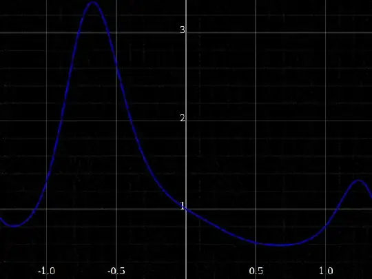

Demo of how the derivative make a tangent that approximates any differentiable function.
This approximation is a truncated Taylor expansion. Its slope is the derivative of the function. So, we have the operator $$\begin{align} \operatorname{approx}_{x_0} &: (\mathbb{R}\to\mathbb{R}) \to (\mathbb{R}\to\mathbb{R}) \\ \operatorname{approx}_{x_0} & f\:(x) = f(x_0) + f'(x_0)\cdot (x-x_0) \end{align}$$
The idea of nabla is to generalise this to higher-dimensional domains.
$$\begin{align} \operatorname{approx}_{x_0} &: (M\to\mathbb{R}) \to (M\to\mathbb{R}) \\ \operatorname{approx}_{x_0} & f\:(x) = f(x_0) + \operatorname{N\!A\!B}(x-x_0) \end{align}$$ There, we need some quantity that can take a local difference vector (a tangent vector in the tangent space $T_{x_0}(M)$) and spit out something similar to... whatever it is that $f$ does when its argument is perturbed by that vector. That quantity is $\operatorname{N\!A\!B}=\nabla f|_{x_0}$.
