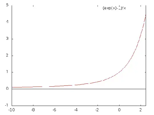

Diagram of $\phi(x)=\begin{cases} \tfrac 1x (e^x-1) & ;x\ne 0 \\ 1 & ;x=0\end{cases}$:
The function $\phi(x)=\tfrac 1x (e^x-1)$

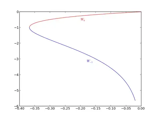

$\alpha > 0$ implies $-\tfrac 1\alpha \in \mathbb{R}^{-}$ and thus $-\tfrac 1\alpha e^{-\tfrac 1\alpha} \in \left[-\tfrac 1e,0\right)$ (The function $z\mapsto ze^z$ maps $\mathbb{R}^-$ to $\left[-\tfrac 1e,0\right)$) The Lambert $W$ function has two branches $W_0$ and $W_{-1}$ on the interval $\left[-\tfrac 1e,0\right)$:
$W_0$ and $W_1$
So we have the two solutions
$$x_1 = -\frac 1\alpha -W_0\left(-\frac 1\alpha e^{-\tfrac 1\alpha}\right)$$ $$x_2 = -\frac 1\alpha -W_{-1}\left(-\frac 1\alpha e^{-\tfrac 1\alpha}\right)$$
One of $W_0\left(-\frac 1\alpha e^{-\tfrac 1\alpha}\right)$ and $W_{-1}\left(-\frac 1\alpha e^{-\tfrac 1\alpha}\right)$ will always be $-\tfrac 1\alpha$ as $W$ is the inverse of the function $z \mapsto ze^z$. This solution of $W$ would give $x=0$ which must be canceled out for $\alpha \ne 1$ as $\phi(x)=1$ just for $x=0$.
