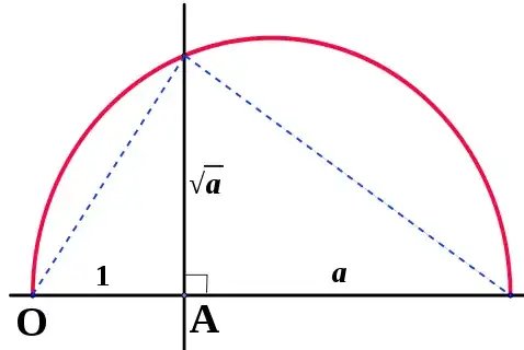

Hint: If $a$ is constructible, then so is $\sqrt a$.
[image from Wikipedia]

The construction is possible and rather straight forward.
First construct a right isosceles triangle with side of $1$
The hypotenuse is $\sqrt 2$
Extend $\sqrt 2$ by $1$ and construct a right triangle whose hypotenuse is $ 1+ \sqrt 2$ and the altitude from the the right angle divides the hypotenuse into segments of length $1$ and $\sqrt 2$
The altitude from the right angle in this triangle has length of $2^{1/4}$ as desired.
Draw a line $AB$ of length $2$, then extend it to $C$ so $AC=3$. Draw a circle with the diameter $AC$, then draw a line perpendicular to $AC$ through $B$. Let it intersect the circle, at both sides of $AC$, at $D$ and $E$.
Then, $BD=BE=\sqrt2$.
Now take $BD$ or $BE$ as the new $AB$ and repeat.
Then the new $BD$ or new $BE$ is $\sqrt[4]{2}$.
DynamoBlaze
  • 2,975
  • To clarify; in repeating the process you do not extend $BD$ or $BE$ to a point $F$ such that $BF=3$, but to a point $F$ such that $BF=\sqrt{2}+1$. – Servaes Mar 22 '18 at 14:32
