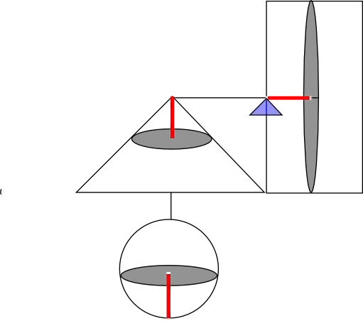

Consider a sphere of radius $r$, and a cone of radius $2r$ and height $2r$.
Slice the cone into circles a distance $x$ below the apex of the cone. The circle at distance $x$ has radius $x$, and hence area $\pi x^2$.
Place the sphere on a level surface, and slice it into circles a distance $x$ above the surface. The radius of such a circle is $\sqrt{x(2r-x)}$, and hence its area is $2\pi xr - \pi x^2$.
Note that the sum of the areas of these circles (one from the cone and one from the sphere) is $2\pi xr$. If you hang them one one side of a balance, a distance $2r$ from the fulcrum, then the total moment is $2r \times 2\pi xr = 4\pi r^2x$.
They can therefore be balanced by a circle of area $4\pi r^2$ (and hence of radius $2r$) a distance $x$ from the fulcrum. Taken together, all these circles make up a cylinder of radius $2r$ and height $2r$.
The preceding five paragraphs are summarized in this picture, where all of the red lines have the same length, and the two gray circles on the left of the fulcrum balance the one on the right.
You can consider all the mass of the cylinder to be concentrated at its center of mass, which is a distance $r$ from the fulcrum. By the leverage principle, the volume of the sphere plus the cone must be equal to the half the volume of the cylinder. The volume of the cylinder and cone are known to be
