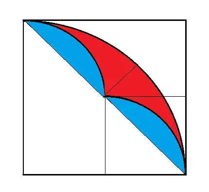

See the image with blue parts shifted:
Animation by User heropup
The single blue figure is the same part of its small square as the red plus both blue of the big square, hence areas $$\frac{2\cdot blue + red}{blue}=\frac{big\ square}{small\ square}=4$$ so $$2\cdot blue + red = 4\cdot blue$$ hence $$red = 2\cdot blue$$ Q.E.D.
Without the formula for the area of a triangle, and without the formula for the area of a circle...

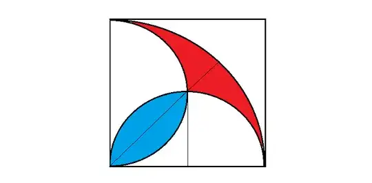

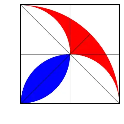

Apply the carpet theorem, see https://www.cut-the-knot.org/Curriculum/Geometry/CarpetsInSquare.shtml. Consider the upper eighth of the big circle and the left halve circle. Since their areas are equal, the areas which are not covered by both must be equal as well, that is the upper half of the red area equals the lower half of the blue one.

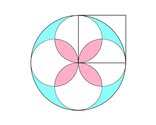

On picture below big circle has same area as 4 small circles of half radius, that's why their intersection (pink color), where only 2 different small circles intersect simultaneously, has the same area as part of big circle not covered by small ones (blue color), it means that one continues blue region equals in area to one pink continues region
