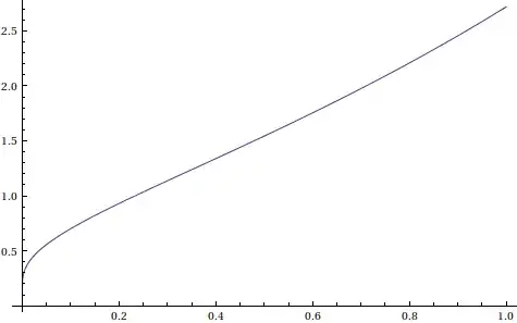

Due to Frullani's integral $\log(k+1)=\int_{0}^{+\infty}\frac{e^{-x}-e^{-(k+1)x}}{x}\,dx $ and the change of variable $x=-\log t$
$$\sum_{k\geq 0}\frac{\log(k+1)}{k!} = \int_{0}^{1}\frac{e^t-e}{\log t}\,dt $$ where it is simple to provide accurate numerical approximations for the RHS, since $\frac{e^{t}-e}{\log t}$ is approximately linear on $(\varepsilon,1-\varepsilon)$ for $\varepsilon>0$ not too close to zero:
$\hspace1in$enter image description here
A better approximation of the integrand function is $e\sqrt{\frac{t(t+1)}{2}}$, for instance.
