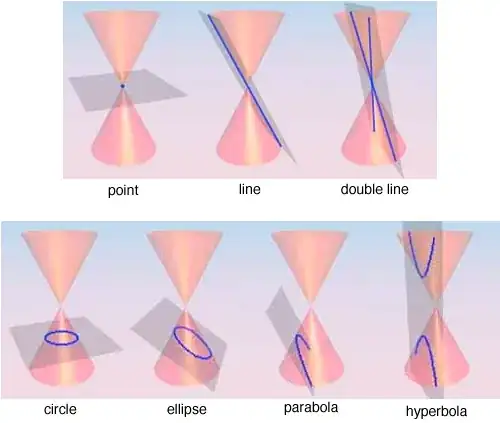

It's a special case that the section plane cutting the radiant point of the cones.
See another answer here for your interest.
