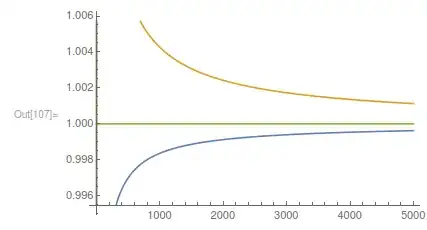

In the following picture, the blue curve is the function $$ f(c)=\frac{x_c}{1+\frac{\log(c)}{c}} $$ and the orange curve is the function $$ g(c)=\frac{x_c}{1+\frac{1}{c}}. $$
It seems that the blue curve reaches the value 1 faster than the orange curve.
Does this mean that it is better to say that $$ x_c\sim 1+\frac{\log(c)}{c}, c\to\infty $$ than to say that $$ x_c\sim 1+\frac{1}{c}, c\to\infty? $$
Note $\frac{1}{c}\leq\frac{\log(c)}{c}$ for large $c$. So I would have expected that $1+\frac{1}{c}$ is a better approximation.

  • I outlined a proof in this answer for the asymptotic $$x_c = 1 + \frac{W(c+1)}{c+1} + \frac{W(c+1)^2}{2(c+1)^2} + o!\left(\frac{(\log c)^2}{c^2}\right)$$ as $c \to \infty$, where $W$ is the Lambert W function. From this we can deduce, for example, that $$x_c = 1 + \frac{\log c-\log\log c}{c} + o!\left(\frac{1}{c}\right)$$ as $c \to \infty$. – Antonio Vargas Feb 25 '18 at 21:47

  • I am just confused because the numerics seem to indicate that $1+\frac{\log{c}}{c}$ is better approximating the sequence $x_c$, Since $x_c\to 1$ this seems to mean that $\log(c)/c$ tends to $0$ more quickly than $1/c$ but thats obviously not true. – mathfemi Feb 25 '18 at 13:51
  • @mathfemi Again, imagine that $x_c$ was equal to $1+\frac{\log c}{c}$. What better approximation than that could you imagine? Yet $\log (c) /c$ still converges to $0$ less quickly than $1/c$. So you see that the two things are totally unrelated. – Arnaud Mortier Feb 25 '18 at 13:57
  • Okay, so for my situation I can only state that $x_c\sim 1+\frac{1}{c}$ and $x_c\sim 1+\frac{\log c}{c}$ as $c\to\infty$ and that numercis suggest that the first approximation is better. – mathfemi Feb 25 '18 at 14:04
  • @mathfemi Yes, precisely. – Arnaud Mortier Feb 25 '18 at 14:18

The fact that your blue line is closer to the green line than the orange line is suggests that $1+\frac{\log(c)}{c}$ is a better approximation to $x_c$
