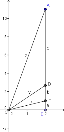

This won't always work out so nicely, and there is likely a shortcut or at least a more efficient way of solving the geometric equations, but here is one approach that works out for a variety of special cases, including $\sqrt[3]{2+11i}+\sqrt[3]{2-11i}$.
Using the polar form of complex numbers, we can see that the value we're looking for is $2\sqrt{5}\cos\left(\dfrac{\arctan\frac{11}{2}}{3}\right)$. We can figure out this cosine by drawing the triangle in the complex plane with vertices $0$, $2$, and $2+11i$ and trisecting the angle at $0$.
right triangle with trisected angle
Then we have the following equations:
  1. $a+b+c=11$ because that is the height of the triangle.
  2. $2^2+a^2=x^2$ by Pythagorean Theorem on smallest triangle.
  3. $2^2+(a+b)^2=y^2$ by Pythagorean Theorem.
  4. $2^2+11^2=z^2$ by Pythagorean Theorem.
  5. $\frac{b}{a}=\frac{y}{2}$ by Angle Bisector Theorem.
  6. $\frac{c}{b}=\frac{z}{x}$ by Angle Bisector Theorem.
  7. $\frac{2}{x}$ is the cosine we're looking for by right triangle trig.
Now we just have to do the terrible algebra: We can eliminate $z$ and $a$ with equations 6 and 2 respectively, to get:
  1. $\frac{b}{\sqrt{x^2-4}}=\frac{y}{2}$ (from 5 above)
  2. $125b^2=x^2c^2$ (from 4 above)
  3. $4+\left(\sqrt{x^2-4}+b\right)^2=y^2$ (from 3 above)
  4. $\sqrt{x^2-4}+b+c=11$ (from 1 above)
Then we can eliminate $y$ with equation 1 to get:
  1. $125b^2=x^2c^2$ (2 above)
  2. $4+\left(\sqrt{x^2-4}+b\right)^2=\dfrac{4b^2}{x^2-4}$ (from 3 above)
  3. $\sqrt{x^2-4}+b+c=11$ (4 above)
From here we have a few options that all can work out (we can eliminate $x$, for instance). Since $x$ is our goal, here is an approach headed that way: Equation 1 tells us that $c=5\sqrt 5b/x$ and equation 3 can be used to eliminate the square root from equation 2, which leaves us with:
  1. $4+(11-5\sqrt5\frac{b}x)^2=\frac{4b^2}{x^2-4}$
  2. $\sqrt{x^2-4}+b+5\sqrt{5}\frac{b}x=11$
Solving 1. for $b$ yields $b=5\sqrt{5}x\dfrac{11x^2-44\pm4\sqrt{x^2-4}}{121x^2-500}$. Since we know $x>2$ and $b<x$, we need the negative root here: $b=5\sqrt{5}x\dfrac{11x^2-44-4\sqrt{x^2-4}}{121x^2-500}$.
Solving 2. for $b$ yields $b=\dfrac{x(11-\sqrt{x^4-2})}{x+5\sqrt{5}}$.
Setting these equal gives us a complicated expression that we can manipulate to solve for the square root: $$\sqrt{x^2-4}=\dfrac{11\left(5\sqrt{5}x^3+4x^2-20\sqrt{5}x\right)}{-121x^2+20\sqrt{5}x+1000}$$
Squaring both sides and putting over a common denominator (and dividing by $4$) gives us: $$\dfrac{121x^6+2420\sqrt{5}x^5+44875x^4-19680\sqrt{5}x^3-429500x^2+40000\sqrt{5}x+1000000}{\left(-121x^2+20\sqrt{5}x+1000\right)^2}=0$$
We only have to worry about the numerator, and since we have $\sqrt{5}$ as a factor of every other coefficient, it will be convenient to substitute $x=\hat{x}*\sqrt{5}$, so that the equation from the numerator becomes $15125\hat{x}^6+302500\hat{x}^5+1121875\hat{x}^4-492000\hat{x}^3-2147500\hat{x}^2-200000\hat{x}+1000000=0$. Testing rational roots tells us we have $\hat{x}=-5,1,-\frac{10}{11},\frac{10}{11}$ as roots. The remaining ones are roots of the resulting quadratic: $\hat{x}=4(-2\pm\sqrt{3})$.
We know $\hat{x}$ must be positive, so it's either $1$ or $10/11$, and checking the other equations shows that $\hat{x}=1$ is correct, which leads to the cosine being $\dfrac{2}{\sqrt{5}*1}$ and the original value being $2\sqrt{5}*\dfrac{2}{\sqrt{5}*1}=4\checkmark$.
