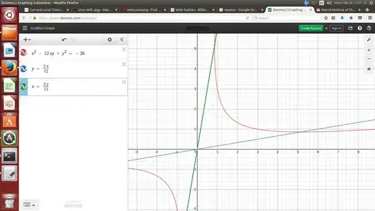

Fair amount of detail if all written out. However, what it comes down to is that, using Vieta Jumping, in the first quadrant, if there are any integer solutions to $$ x^2 - Bxy + y^2 = -2(B+1), $$ then there must be integer solutions, Hurwitz's Fundamental Solutions, in the bounded arc with between the point of minimum $y$ and the point of minimum $x,$ meaning in $$ x \geq \frac{2y}{B} $$ and $$ y \geq \frac{2x}{B} $$ In the picture, we see integer points $(3,1)$ and $(1,3)$ between the slanted lines.

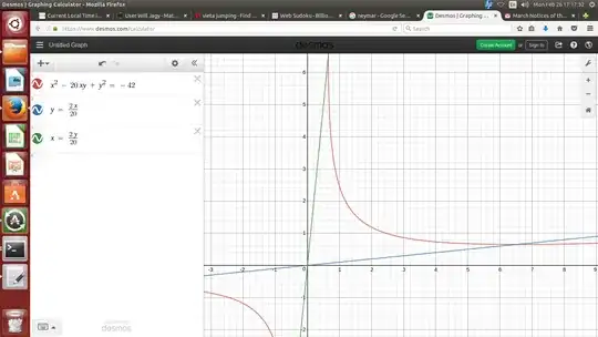

enter image description here However, when $B > 12,$ and we ask about the smaller value of $x,$ we find that it is $$ \frac{4B+6}{B + \sqrt{B^2 - 8B -12}} $$ and $$ 2 < \frac{4B+6}{B + \sqrt{B^2 - 8B -12}} < 3 $$ enter image description here In turn, this means that there are no integer points on the arc between the slanted lines, and no integer points at all, when $B > 12.$
