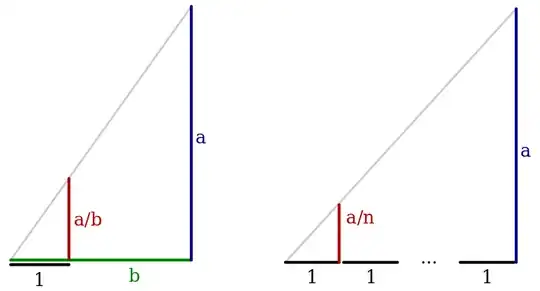

Given: 3 lines (longest one a, medium one b and unit 1)
How can you construct line segments of lengths $a/b$, $\sqrt {a}$ and $a/n$ with $n$ a positive integer?
Here are ideas for the fractions $a/b$ and $a/n$:
