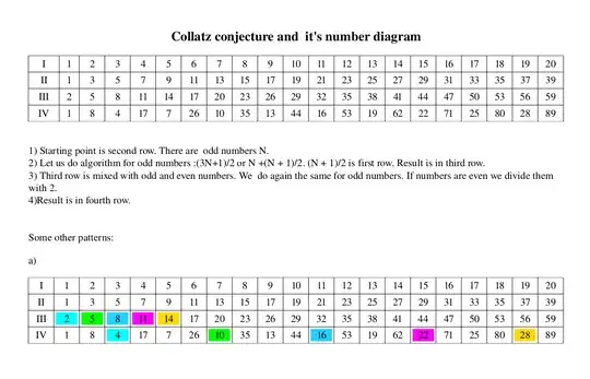

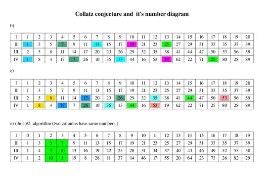

Also, are the following diagrams meaningful?
diagram 1
diagram 2
First row of "Collatz" number diagram can be seen as N, second as 2N-1, third as 3N-1
If you look at diagram a), you can see that positional value y betwen 2x in forth row and x in third row is given by formula 4y-1
diagram 3
2 in column 1 => 4 in column 3
5 in column 3 => 10 in column 11
14 in column 5 => 28 in column 19
Another very naive, probably stupid but do not care subquestion? Finding some solution for $(3n-1)/2$ is the same as solving system of equations with 2 unknowns.
Look at last diagram. Can there be some generality written?
