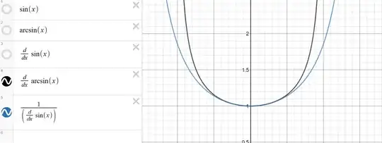

I was trying to find the derivative of $$\arcsin(x) = \sin^{-1}(x)$$
I thought that I could use the rule of inversion:
$$({f^{-1}})'(x) = \dfrac{1}{f(x)'}$$
Therefor the derivative of $\arcsin(x)$ should be: $$\dfrac{1}{\cos(x)}$$
But for some reason, this seems to only work for small $x$. Where did I do a mistake?
Greetings, Finn

Because the rule is$$\left(f^{-1}\right)'(x)=\frac1{f'\left(f^{-1}(x)\right)}$$and therefore\begin{align}\arcsin'(x)&=\frac1{\cos\bigl(\arcsin(x)\bigr)}\\&=\frac1{\sqrt{1-\sin^2\bigl(\arcsin(x)\bigr)}}\\&=\frac1{\sqrt{1-x^2}}.\end{align}
With $$\sin(y)=x$$ we get $$\cos(y)\frac{dy}{dx}=1$$ so $$\frac{dy}{dx}=\frac{1}{\cos(y)}$$ therefore $$\frac{dy}{dx}=\frac{1}{\sqrt{1-x^2}}$$
