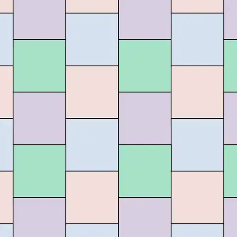

In addition to the good answers you have got so far, I think the tiling problem also fits in the scope of this question. In higher dimensions (and even in the 3D space), the tiling problem becomes highly complex and some strange results appear.
One seemingly obvious observation that becomes invalid in higher dimensions is Keller's conjecture, which states that
In any tiling of Euclidean space by identical hypercubes there are two cubes that meet face to face. For instance, as shown in figure below, in any tiling of the plane by identical squares, some two squares must meet edge to edge.
keller
And I quote the rest from wikipedia:
It was shown to be true in dimensions at most 6 by Perron (1940). However, for higher dimensions it is false, as was shown in dimensions at least 10 by Lagarias and Shor (1992) and in dimensions at least 8 by Mackey (2002), using a reformulation of the problem in terms of the clique number of certain graphs now known as Keller graphs. Although this graph-theoretic version of the conjecture is now resolved for all dimensions, Keller's original cube-tiling conjecture remains open in dimension 7.
More precisely, the reduction to Keller graphs is equivalent to making the assumption that all hypercubes have integer or half-integer coordinates. (For example, this may be true in the image above if we assume that each vertical stripe is shifted exactly half a square's height from the stripe to its left.) So the progress on the problem to date can be summarized as:
  1. Lagarias and Shor showed that even under this restriction, counterexamples to Keller's conjecture can be found in $d \ge 10$ dimensions.
  2. Mackey extended this result to $d = 8$ dimensions (which implies $d=9$, too, since we can stack a bunch of 8-dimensional tilings on top of each other, shifted so none of the hypercubes in adjacent layers share faces).
  3. However, Debroni et al. (2010) showed that all tilings with half-integer coordinates in $d=7$ do satisfy this conjecture.
This leaves the $d=7$ case open, but implies that if a counterexample does exist in $7$ dimensions, it must look weird and have less structure than any of the higher-dimensional counterexamples we've found.

There is already a great gap between 2 and 3 dimensions.
Here is a mildly interesting but very simple one I came up with, when thinking about this very question some time ago:
There is no partition of the 2d-plane into a finite number of path-connected regions that are translations of one another. But there is a partition of the 3d-space into just two path-connected regions that are translations of one another!
