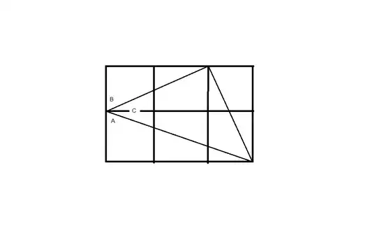

Three angles of a triangle sum to 180 degrees
Consider this figure. (the grid is a square grid.)
Angles $A+B+C$ sum to $180.$
$A$ is an angle with measure $\arctan 3.$
$B$ has measure $\arctan 2$
What is the measure of angle $C$?
It is an isosceles right triangle.
