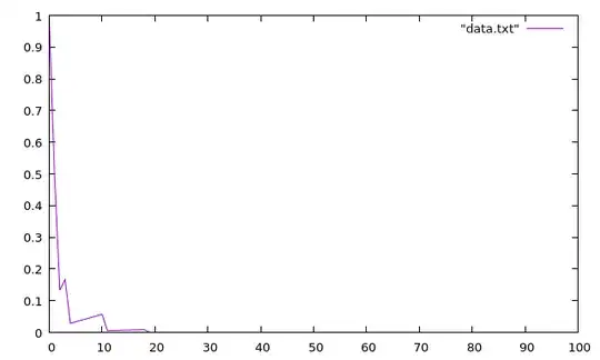

I plotted $\frac{n}{\text{product of all primes less than $3 \log_2{n}$}}$ to support the conjecture. Here it is for for $n$ from $2$ to $100$.
I computed the values for $n$ up to one million and the ratio gets smaller and smaller, supporting the conjecture.

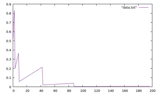

I then repeated the same experiment but with $\frac{n}{\text{product of all primes less than $2 \log_2{n}$}}$. Here it is for for $n$ from $3$ to $200$.
So it seems that the product of all primes less than $2 \log_2{n}$ might also work.
