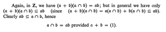

You're right, the statement is false for general rings. As is remarked in Atiyah-Macdonald (page 6),
An example of a ring where the statement is false is $\mathbb{Z}[x]$, e.g. with $\mathfrak{a}=(2)$ and $\mathfrak{b}=(x)$. We have $$(\mathfrak{a}+\mathfrak{b})(\mathfrak{a}\cap\mathfrak{b})=(2,x)(2x)=(4x,2x^2)\subsetneq (2x)=\mathfrak{a}\mathfrak{b}.$$
