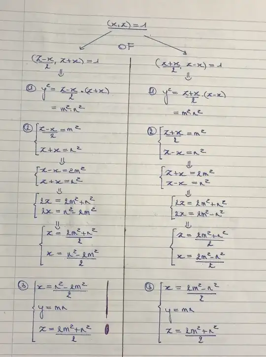

  • Thnx! Clear! But how can you solve $(z−x^2)/2=m^2$ and $z−x=n^2$ for x and y to become the values for x, y and z? – WinstonCherf Jan 28 '18 at 14:34
  • Ok, so rewriting we have $z-x=2m^2$ and $z+x=n^2$. If you add these to equations together you get $2z+0=2m^2+n^2$, dividing by $2$ yields $z=\frac{2m^2+n^2}{2}$. Now that you know what $z$ is, can you find out what $x$ is? – cansomeonehelpmeout Jan 28 '18 at 14:40
  • Thnx! I found it! There's just one thing not clear to me: First we say $y^2=((z-x)/2)((z+x)/2)$ and next we say $y^2=((z-x)/2)(z+x)$ and later on $y^2=((z+x)/2)(z-x)$. Why is this true? – WinstonCherf Jan 29 '18 at 10:10
  • @Elce I have updated my answer, please tell me if it is more helpful now! We don't say that $y^2=\left ( (\frac{z-x}{2})(\frac{z+x}{2})\right )$, we start with: $2y^2=(z-x)(z+x)$, then we divide by the $2$. Now we can choose which factor to divide by $2$, and the result is still the same. For instance $\frac{4}{2}\times 6=2\times 6$ is still the same as $4\times\frac{6}{2}=4\times 3$. But notice that $\gcd(2,6)=2$ and $\gcd(4,3)=1$. So we are choosing to divide by the factor that gives a $\gcd$ of $1$. – cansomeonehelpmeout Jan 29 '18 at 15:53
  • Thanks a lot! Jus one question: The solutions says $x=(m^2-2n^2)/2,y=mn,z=(m^2+2n^2)/2$ But I become other values. Are they wrong? I uploaded the picture! – WinstonCherf Jan 29 '18 at 19:17
    @Elce everything you have done seems perfect. I'm sure the book have made some typos. – cansomeonehelpmeout Jan 29 '18 at 19:27
