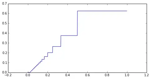

I think you lack intuition for this type of problem. The infinite sum of heaveside functions is a step function or even a renewal process if you let the $a_n$ and $x_n$ be random numbers.
Why not use mathematica and let $x_n = \frac{k}{M}$ for $M >> 1$ and $a_n = f(x_n)$, for example?
http://demo.activemath.org/ActiveMath2/LeAM_calculusPics/StepFunction.png?lang=en

Example: $ \displaystyle \sum_{n=1}^\infty \frac{1}{n^2} H\left(x - \frac{1}{n}\right) $
