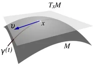

Given a locally Euclidean (locally homeomorphic to some Euclidean space) subset $X\subset\mathbb R^n$ and $p\in X$, let $\widetilde{\mathrm{T}}_pX$ denote the tangent set of $X$ at $p$, namely the set of derivatives of differentiable curves in $X$ based at $p$.
Suppose for all $p\in X$ we have that $\widetilde{\mathrm{T}}_pX$ is a linear subspace of $\mathbb R^n$ of dimension $\dim_pX$. Does it follow that $X\subset\mathbb R^n$ is an embbeded differentiable submanifold?
