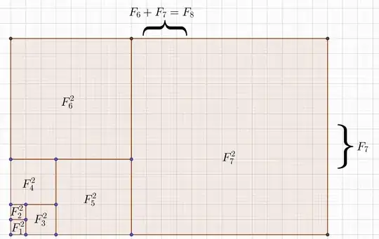

11
From the figure below the theorem's proof comes. The rectangle's area is $F_{i}F_{i+1}$.
Pet123

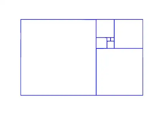

This identity can be seen readily in the Fibonacci mosaic below. Clearly, the area of the overall rectangle, $F_{n+1}\times F_{n}$ is the sum of the areas of the individual squares $F_{k}\times F_{k}$ from $k=1:n$.
Fibonacci Mosiac
Cye Waldman
  • 8,196
    This does not address the question asked and was posted over an hour after Pet123's post, from which it differs only in arranging the squares in a spiralling pattern instead of building from a corner. What was the point? – Paul Sinclair Jan 21 '18 at 04:53
  • @PaulSinclair Thanks for your comment. (1) I didn't see Pet123s at the time I typed this up and (2) my diagram is actually the template for the Fibonacci spiral and is more recognizable and well known. As for why I didn't see the post, I had the page open for over an hour while I falsely pursued the identity $\sum_1^n F_kF_{k-1}=F_n^2,~n \text{ even}$ with another mosaic. – Cye Waldman Jan 21 '18 at 16:33
