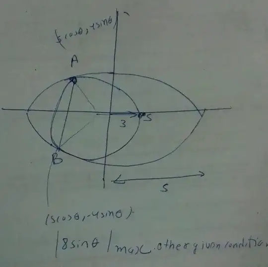

A circle passes through a point on $x$ axis vertically ( like point $(3,0) $ shown) and has its center on $y=0$ and touches the ellipse at $A$ and $B$. What is the range of chord of contact $AB$ ?
Known answer: $$ 4 < AB <7 \,$$
My approach in the sketch my approach

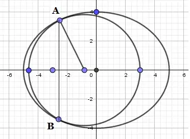

EDIT:
A variable circle centered on $x$ axis touches an ellipse $ (a=5,b=4),$ passes through a typical point such as $(3,0)$ as shown. Find range of distance between ellipse/circle tangent points ( length of contact chord ).
