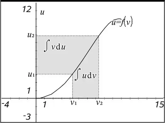

Unfortunately you can’t comment an image, but I think this visual would supplement the above answers very nicely:
To see how this relates to the product rule, take qbert’s answer and change $f(t)$ and $g(t)$ with $u$ and $v$.
You can see how this works for definite and indefinite integrals by taking the standard integration by parts formula,
$$\int v \, du = uv - \int u\,dv$$
and evaluating it between the points $(v_1,u_1)$ and $(v_2,u_2$), giving you
$$\int_{u_1}^{u_2} v \, du = u_2v_2 - u_1v_1 -\int_{v_1}^{v_2} u\,dv$$
Side note: I hate doing integration by parts with $u$ and $v$ — they just look too similar! That’s why I prefer to use $w$ and $z$.

I don’t understand why someone downvoted this. Was it to balance out the +2 score or was it because this is all-around bad? – gen-ℤ ready to perish Jan 16 '18 at 04:24
4Actually it appears that someone downvoted every single answer, so maybe I shouldn’t be too concerned. – gen-ℤ ready to perish Jan 16 '18 at 04:30
4I'm not the downvoter, but it seems like the question is more asking about why there doesn't exist a formula for $\int uv$, which none of the answers address. – Carmeister Jan 16 '18 at 06:22
@Carmeister That makes sense. I think the implicit answer is that there does exist an integral analogue to the product rule, and that analogue is integration by parts. Do you agree? – gen-ℤ ready to perish Jan 16 '18 at 06:33
