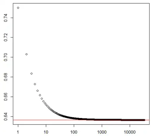

I tried evaluating LHS by hand, and the partial products slowly do decrease towards RHS, and we know that they will not decrease forever because $$\lim_{n\to\infty} \frac{n^2-1}{n^2}=1$$ so can anyone help by writing a program which can do partial sum up to high values of n and tell me if its true. PS.I am in 10th standard do if im wrong anywhere please dont explain in too complicated mathematics. thanks
$\dfrac2{\pi} \approx 0.6366198$ is the correct limit of the product
As an illustration (not a proof) using R:
maxn  <- 2^15
plot(exp(cumsum(log(1 - (2*(1:maxn))^(-2)))), log="x")
abline(h=2/pi, col="red")
giving
