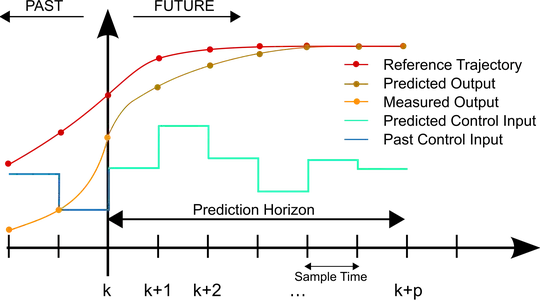

Model Predictive Control(MPC) is the second most used controller after PID. The benefits of MPC is that MPC can predict the future states and therefor change the control input after that.
A MPC controller store the past last state $x_N$ and past last input $u_N$ in the memory. Then the MPC controller simulate the future states $x$ with one constant input $u_N$ and initial states $x_N$:
$$x = A^kx_N + \sum_{i=0}^kA^iBu_N$$
and then MPC use the discrete quadratic cost function for LQR:
$$J = \sum_{i=0}^N(x_i^TQx_i + u_i^TRu_i) +x_N^TPx_N $$
Where $P, Q, R > 0$ are matrices from the user.
The key think here is that we first simulate a state response from initial state and constant input, which are from the last measured state and last input applied onto the system.
If we instead simulate a state response with initial state $x_N$ and last input $u_N$. But in this case, $u_N$ differs user choice.
So we begin with to do a state response
Then we change $u_N$ to a lower value or higher:
$$x_1 = A^kx_N + \sum_{i=0}^kA^iB(u_N + 1)$$ $$x_2 = A^kx_N + \sum_{i=0}^kA^iB(u_N + 2)$$ $$x_3 = A^kx_N + \sum_{i=0}^kA^iB(u_N + 3)$$ $$x_4 = A^kx_N + \sum_{i=0}^kA^iB(u_N + 4)$$ $$\vdots$$ $$x_L = A^kx_N + \sum_{i=0}^kA^iB(u_N + L)$$
Then we check which $J$ are smallest:
$$J = \sum_{i=0}^N(x_i^TQx_i + u_i^TRu_i) +x_N^TPx_N $$ $$J_1 = \sum_{i=0}^N(x_{1i}^TQx_{1i} + u_{1i}^TRu_{1i}) +x_N^TPx_N $$ $$J_2 = \sum_{i=0}^N(x_{2i}^TQx_{2i} + u_{2i}^TRu_{2i}) +x_N^TPx_N $$ $$J_3 = \sum_{i=0}^N(x_{3i}^TQx_{3i} + u_{3i}^TRu_{3i}) +x_N^TPx_N $$ $$J_4 = \sum_{i=0}^N(x_{4i}^TQx_{4i} + u_{3i}^TRu_{4i}) +x_N^TPx_N $$ $$\vdots$$ $$J_L = \sum_{i=0}^N(x_{Li}^TQx_{Li} + u_{Li}^TRu_{Li}) +x_N^TPx_N $$
Let's say that $J_4$ become the smallest and then we know which input we need to apply to the system, for only this iteration.
Question:
Is this how MPC works?
Insted of discrete LQR cost function:
Can I use this insted?
$$J = \sum_{i=0}^N(r- y_i)$$
Where $y$ is output from state response
$$y = C[A^kx_N + \sum_{i=0}^kA^iBu_N]$$
and $r$ is the reference?
Everybody says that the state vector $x$ should be zero when the system meets the reference, but I don't agree with that. The state velocities goes to zero, that's correct, but not the position states.
  1. We simulate some different state responses of different inputs, but the initial state is the same
  2. We use the state responses and inputs to check which one minimizes the cost function
  3. After we have found the smallest value of the cost function, then we know which input is the best one for just this iteration in the controller.
  4. Go to step 1.
