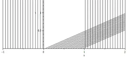

The present PDE is the inviscid Burgers' equation. A sketch of the characteristic curves in the $x$-$t$ plane is
characteristics
Along these curves, $u$ is constant and equal to its value at $t=0$, deduced from the initial data $f(x)$ (similar to a rectangular function).
  • One can observe that the characteristic curves separate at $x=0$: the edges are the lines $x=0$ on the left, and $x=2t$ on the right. According to the Lax entropy condition, a rarefaction wave occurs. Such a wave is a self-similar continuous solution, i.e. $u(x,t) = v(x/t)$. In the case of Burgers' equation, one shows that $v(x/t) = x/t$ (cf. e.g. this post).
  • At $x=1$, characteristics cross: a shock wave occurs. Starting from the intersection of characteristics, the method of characteristics is not valid anymore. The speed of shock $s$ is given by the Rankine-Hugoniot condition $s = \frac{1}{2}(2 + 0) = 1$. The shock wave is located on the line $\frac{x-1}{t} = s$, i.e. $x = 1+t$.
Therefore, as long as both waves do not interact, the solution is $$ u(x,t) = \left\lbrace \begin{aligned} &0 & &\text{if}\quad x\leq 0\\ &x/t & &\text{if}\quad 0\leq x \leq 2t\\ &2 & &\text{if}\quad 2t\leq x<1+t\\ &0 & &\text{if}\quad 1+t<x \, . \end{aligned} \right. $$ Both waves will interact at some time $t^*$ such that $2t^* = 1+t^*$, i.e. $t^* = 1$. The rarefaction wave catches the shock.

  • The region for which $u(x,t) = 2$ is given by $2t<x<1+t$, but why is that? Which theorem/result imply that? Right now it looks like it come out of nowhere. The shock speed from Rankine-Hugoniot condition seems to be playing a role, too. Can you elaborate little more on those? – dezdichado Jan 09 '18 at 23:53
    @dezdichado The location of the edges of the rarefaction follows from the expression of characteristic curves. In particular, the right edge has equation $x=2t$. The curve $x=1+t$ where the shock is located is deduced from R-H. Between those two curves, one has $u=2$, since $u$ is constant along characteristics. – EditPiAf Jan 10 '18 at 00:55
