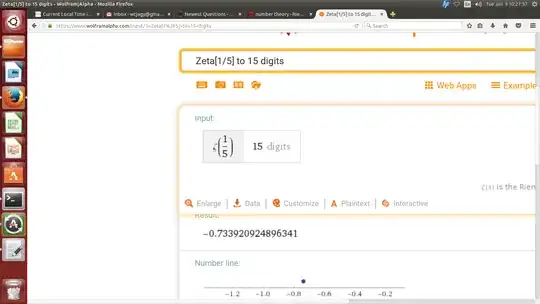

Here is an estimate of $\zeta\left( \frac{1}{5} \right)$ using Daniel's expansion as far as the $3+\sigma$ term, ignoring $5+\sigma$: $$ \zeta(\sigma) =\left( \sum_{k=1}^n \frac{1}{k^\sigma} \right) - \frac{n^{1-\sigma}}{1-\sigma} - \frac{1}{2 n^\sigma} + \frac{\sigma}{12 n^{1 + \sigma}} - \frac{\sigma (1 + \sigma)(2 + \sigma)}{720 n^{3+\sigma}} + O \left( \frac{1}{n^{5 + \sigma}} \right)$$ I think it will let me fit 33 lines in a "code" window without introducing a scroll bar.
    1   1                   -0.7340666666666666
    2   1.870550563296124   -0.7339263390330826
    3   2.673292125056355   -0.7339216399387463
    4   3.431150408311554   -0.7339210905379737
    5   4.155930071989249   -0.7339209776636304
    6   4.854757190760828   -0.7339209455319796
    7   5.532368104161309   -0.7339209342063361
    8   6.192122059547756   -0.7339209295629763
    9   6.836516074525011   -0.7339209274322004
   10   7.467473419005204   -0.7339209263652269
   11   8.086517339689049   -0.7339209257924113
   12   8.694881681582254   -0.7339209254668952
   13   9.293584537123753   -0.7339209252729478
   14   9.883479099480143   -0.7339209251526775
   15   10.46528985863283   -0.7339209250754953
   16   11.03963903613135   -0.7339209250244763
   17   11.60706632180293   -0.7339209249898626
   18   12.16804389452603   -0.7339209249658375
   19   12.72298804735438   -0.7339209249488197
   20   13.27226831900744   -0.7339209249365428
   21   13.81621476189632   -0.7339209249275397
   22   14.35512379575268   -0.7339209249208374
   23   14.8892629725969    -0.7339209249157863
   24   15.41887489312131   -0.7339209249119263
   25   15.94418045400206   -0.733920924908948
   26   16.46538156214071   -0.7339209249066238
   27   16.98266342011249   -0.7339209249047942
   28   17.49619646365717   -0.7339209249033369
   29   18.00613801451264   -0.7339209249021712
   30   18.51263369862476   -0.7339209249012291
   31   19.01581866962328   -0.733920924900462
   32   19.51581866962328   -0.7339209248998368
   33   20.0127509533112    -0.7339209248993227
