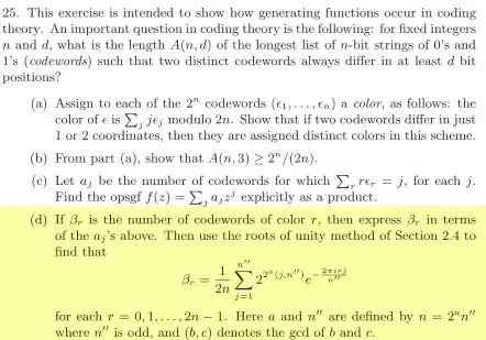

A question from Herbert Wilf's generatingfunctionology book (part (d) of the question):
Question
Just for illustration: $$0010 \,\, 0100 \,\, 0001 \,\, 1000$$ Would be an example where we have 4 codewords (each of length $n=4$), where if we take any two distinct codewords above we have only one position where the bit differs. Easily this means $A(4,1) \geq 4$.
The color of a codeword is defined as $\sum _{j=1} ^{n} j\epsilon_j \mod{2n}$. For example, the 6-length codeword $101101$ would have the color: $$1*1 + 2*0 + 3*1 + 4*1 + 5*0 + 6*1 \equiv 14 \equiv 2 \mod 12$$

I am unsure how to proceed from here, or if this approach is even the way to go about it (considering it says to use the 'roots of unity' method). Firstly, I am unsure how to deal with $f(z) = \sum_j a_j z^j = \prod_{k=1} ^{n} (1+z^k)$, especially what to do with the product of $(1+z^k)$ in equation $(3)$.
Thus, I'd like to ask (more preferably hints) help on how to approach this question, or if the working out above is even correct.

$$\bbox[5px,border:2px solid #00A000]{\Large \frac{1}{2n} \sum_{j=1}^{n''} e^{-2\pi i rj/n''} 2^{2^a \gcd(j, n'')}.}$$
