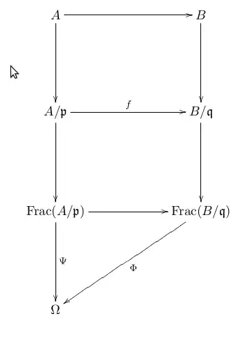

We know that $\mathfrak{p} = \ker \psi$ is a prime ideal of $A$ since the image of $\psi$ is an subring of $\Omega$, in particular an integral domain. The lying-over theorem implies that there exists a prime ideal $\mathfrak{q}$ of $B$ lying over $\mathfrak{p}$ since $B$ is integral over $A$. Now consider the compositum $ A \to B \to B/\mathfrak{q}$. The kernel of this compositum is precisely $\mathfrak{p}$ and so we have an injective homomorphism
$$f : A/\mathfrak{p} \to B/\mathfrak{q}$$
such that $B/\mathfrak{q}$ is integral over $A/\mathfrak{p}$. Taking fraction fields, we have that $\textrm{Frac}(B/\mathfrak{q})$ is an algebraic extension of $\textrm{Frac}(A/\mathfrak{p})$. The following steps will now complete the problem:

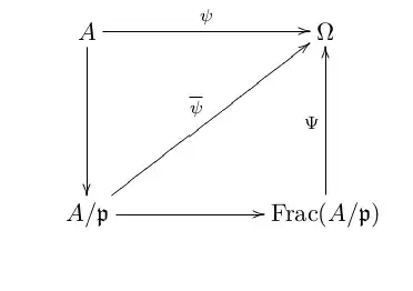

  1. The universal property of quotients gives us a unique ring homomorphism $\overline{\psi} : A/\mathfrak{p} \to \Omega$ that is injective.
  2. The universal property of the fraction field now gives a unique ring homomorphism $\Psi: \textrm{Frac}(A/\mathfrak{p} ) \to \Omega$ that extends $\psi$.
  3. Use Theorem 1. of Keith Conrad's notes here to give us a homomorphism $\Phi : \textrm{Frac}(B/\mathfrak{q}) \to \Omega$.
  4. The desired homomorphism from $B$ to $\Omega$ is obtained by doing $$B \to B/\mathfrak{q} \to \textrm{Frac}(B/\mathfrak{q}) \stackrel{\Phi}{\longrightarrow} \Omega. $$
We can put this all in two diagrams:
