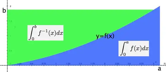

First note that we have $$ab \leq \int_0^{a} f(x) dx + \int_0^{b} f^{-1}(x) dx $$ for any strictly increasing integrable function $f(x)$. The geometric interpretation is from looking at the area of the rectangle with coordinates $(0,0)$,$(a,0)$,$(a,b)$ and $(0,b)$ and comparing it with the areas given by the integrals. From the image it is also clear that the equality hold only when $b=f(a)$.
To get the Young's inequality, choose $f(x) = x^{p-1}$.
I have added the following picture for clarity. enter image description here
The image was made using grapher and some post processing was done using LaTeXiT and preview on Mac OSX.
