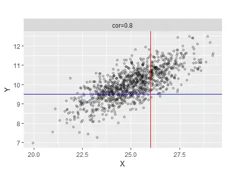

Next question, referring to the picture below, does taking expectations along the red lines (conditionning on X) or along the blue lines (conditioning on Y) yield the same line in this picture ?
I can see that these equations are different, but that is because they are in another basis, do these equations represent the same line ?
