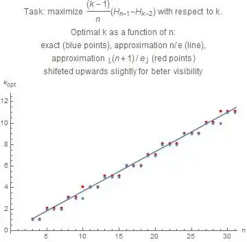

EDIT: graph and approximation improved
The following graph compares the exact optimal value of k with the approximations $k_{appr1} = n/e$ and $k_{appr2}=\left\lfloor (n+1)/e\right\rfloor$
We gather from the graph that $k_{appr2}$ is an almost pointwise correct approximation to $k_{opt}$ which fails only in very few points at the ends of the steps of the "staircase" (see $n=10$ and $n=29$).
