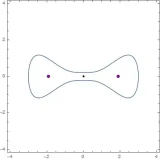

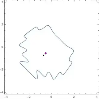

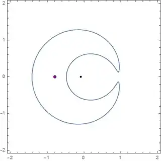

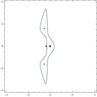

Here are some examples. I'm unable to solve my center in closed form.
$2x^2+2y^2+7y\sin{(xy)} + 7x\sin{(x)}=1$
Center1
$x^2 + x + y^2 + y + \sin(xy) + \sin(3xy)=4$
Center2
$(x^2+y^2-1)^2+.415x=.4$
Center3
$81y^2-x^4\left(9-x^2\right)=4$
Centers4
