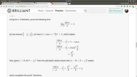

I was going through the following proof:
Why is the inequality given in the first line of the proof true? As cos 0 = 1, in the interval (-/2, /2), how can cos x be strictly less than 1?
Why is $cos x < \frac{sin x}{x} $?

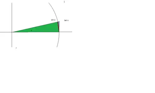

The area of the green triangle is $\frac 12 |\sin x|$
The area of the section of the circle (green + red) is $\frac 12 |x|$
And the area of the larger triangle (green + red + blue) is $\frac 12 |\tan x|$
$|\sin x| \le |x| \le |\tan x|$
then with some algebra.
$1 \le \frac {x}{\sin x} \le \sec x\\ \cos x \le \frac {\sin x}{x} \le 1\\ $

I am afraid that there are all sort of things wrong with the proof you show.
You are right that for $x = 0$ we have $\cos(0) = 1$, so the inequality $$ \cos(x) < 1 $$ certainly does not hold on the interval $\left(\frac{-\pi}{2}, \frac{\pi}{2}\right)$. Even worse, the stated inequality $$ \cos(x) < \frac{\sin(x)}{x} < 1 $$ does not even make sense for $x = 0$, since the middle term is not defined.
