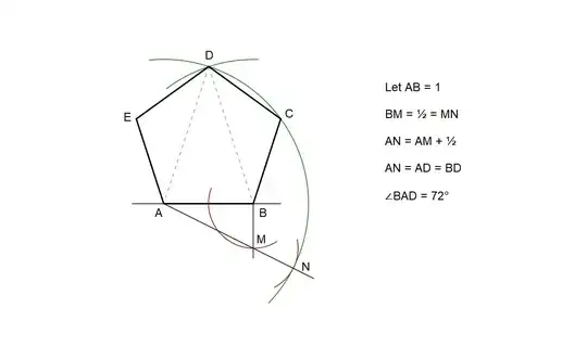

This is how to construct a regular pentagon using only a compass and straightedge without measurements. enter image description here
Seyed
  • 9,041
  • can you tell how you found the point C? did you use the compass to draw an arc of radius AB to intersect the green arc? – user500668 Dec 28 '17 at 14:40
  • @user500668, You have the $AN$ which is equal to $AD$ and $AC$, and you also have $AB$ which is the same as $BC$. To find the point $C$ you just need to make two arcs center at $A$ and $B$ and radius $AN$ and $1$. – Seyed Dec 28 '17 at 16:17
