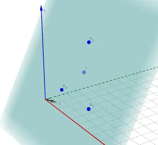

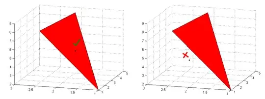

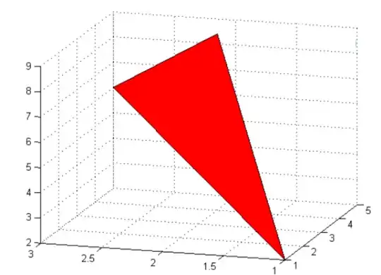

In my game I have 3 points that create a triangular plane similar to the image below but with uniform coordinates:
Each tringle is made of 3 points e.g.
P0 (x,y,z)
P1 (x,y,z)
P2 (x,y,z)
I also have the point:
P (x,y,z)
As shown in the diagram below, is is possible to tell if the plane created by P0, P1 & P2 passes through P?
I have looked online however all results do not seem to fit the problem in a programming orientated approach. Ideally i'd like to pass the coordinates to a function/equation and get a true/false result.
Thanks
Andrew

Assume $P$ falls within the plane. If you need to further test whether $P$ is inside $\triangle_{P_1P_2P_3}$, you can compute the area of the four triangles $\triangle_{PP_1P_2}$, $\triangle_{PP_2P_3}$, $\triangle_{PP_3P_1}$ and $\triangle_{P_1P_2P_3}$ by any formula you know, e.g.
$$A_{PP_1P_2} = \verb/Area/(\triangle_{PP_1P_2}) = \frac12| (P_1 - P)\times(P_2 - P)|$$ Point $P$ will be on or within the triangle if and only if
$$A_{PP_1P_2} + A_{PP_2P_3} + A_{PP_3P_1} = A_{P_1P_2P_3}$$

  • $\mathbf{P}_0 = \pmatrix{1 & 1 & 1}^\top$, $\mathbf{P}_1 = \pmatrix{5 & 1 & 1}^\top$, $\mathbf{P}_2 = \pmatrix{2 & 3 & 5}^\top$ and $\mathbf{P} = \pmatrix{3 & 2 & 3}^\top$
pic
  • Find normal vector $$ \mathbf{n} = \frac{ (\mathbf{P}_1-\mathbf{P}_0) \times (\mathbf{P}_2-\mathbf{P}_0)}{ \| (\mathbf{P}_1-\mathbf{P}_0) \times (\mathbf{P}_2-\mathbf{P}_0) \| } = \pmatrix{0 \\ -\frac{2}{\sqrt{5}} \\ \frac{1}{\sqrt{5}} }$$
  • Check that distance to plane is zero $$d = \mathbf{n} \cdot (\mathbf{P}-\mathbf{P}_1) = 0\;\checkmark$$
  • Build coefficient matrix $$\mathcal{A} = \left| \matrix{\mathbf{P}_0 & \mathbf{P}_1 & \mathbf{P}_2 \\ 1 & 1 & 1} \right| = \left| \matrix{1 & 5 & 2\\ 1 & 1 & 3 \\ 1 & 1 & 5 \\ 1 & 1 & 1} \right| $$
  • Find barycentric coordinates
$$\pmatrix{w_0 \\ w_1 \\ w_2} = \left( \left| \matrix{1 & 5 & 2\\ 1 & 1 & 3 \\ 1 & 1 & 5 \\ 1 & 1 & 1} \right|^\top \left| \matrix{1 & 5 & 2\\ 1 & 1 & 3 \\ 1 & 1 & 5 \\ 1 & 1 & 1} \right| \right)^{-1} \left| \matrix{1 & 5 & 2\\ 1 & 1 & 3 \\ 1 & 1 & 5 \\ 1 & 1 & 1} \right|^\top \pmatrix{3\\2\\3\\1} = \pmatrix{\frac{1}{8} \\ \frac{3}{8} \\ \frac{1}{2} } $$
  • Since all coordinates $w_0$, $w_1$ and $w_2$ are postive and less than one the point is inside the triangle.
