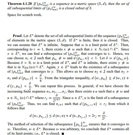

Below is a theorem from these notes. I have two questions:
  1. Why can we make $d(p_{n_1},w) < 1$? I think this is a typo and what is meant is $d(p_{n_1},x)<1$. (And so $d(p_{n_1},w) \le 2$.) Is my vision correct?
  2. Why do we need to define $\delta$? Can I just replace $\delta$ with $1$ everywhere without making any other corrections? I think this will only make the proof easier to understand. Or do I miss something?

    For your first question the answer is it is possible to choose $n_1$ such that $d(p_{n_1},w)<1$. Since $d(x,w)<1$ we can choose $n_1$ such that $d(p_{n_1},x)<1-d(x,w)$ and then triangle inequality gives $d(p_{n_1},w)\leq d(p_{n_1},x)+d(x,w)<1$. For the second question It appears to me that you are right: $\delta =1$ seems to work just fine. – Kavi Rama Murthy Dec 25 '17 at 05:18
Regarding your two questions:
  1. I think this is not a typo and it is intentionally writen $d(p_{n_1},w)<1$, since, $(p_n)$ being a subsequence converging to $x$ means that it can get arbitrarily close to $x$ and, since $x$ belongs to the unitary open ball around $w$, evidently we can find a term of $(p_n)$ inside that 1-ball around $w$ - it is open and $x\in N_1(w)$, so there exists an $r>0$ such that $N_r(x)\subseteq N_1(w)$. So, this explanation might just have been ommitted for reasons of clarity simplicity.
  2. Well, actually, any consant value would be adequate since, what matters is that denominator $2^j$ that is of exponential rank. However, $\delta$ is the most elegant choice so as to ensure some kind of monotonicity for our subsequence.
