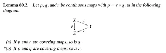

Here I assume that both $E$ and $X$ are path connected and locally path connected, and the section $f$ is continuous. Such assumptions are really natural when dealing with the covering map.
Then there is a really quick way to solve the problem.
I will use Munkres Lemma 80.2:
Let $p=id_X:X\rightarrow X, q=f: X\rightarrow E, r=q: E\rightarrow X$. Lemma 80.2 tells us that $f$ is a covering map. Since $f$ is injective, f is a homeomorphism. We have $id_X=q\circ f$. Thus q is a homeomorphism.
- 477
