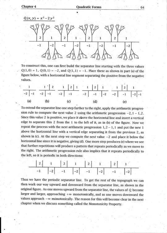

Here is the Conway topograph for the negative of your form, $x^2 - 2 y^2.$ Your numbers show up representing negative number, (4,3) gives $-2$, then (7,5) gives $-1,$ then (24,17) give $-2,$ (41,29) gives $-1$
Let's see, it will take an hour or so, but I can draw a topograph for $2x^2 - v^2$ that shows numbers represented up to $17,$ as numbers such as $4,8,9$ are not squarefree, and are not primitively represented (we get $\gcd(x,v) \neq 1$). Will, 9:19 Pacific time
Done. Note that the green coordinate pairs have a motion that gives the same value of $2x^2 - y^2,$ namely $$ (x,y) \mapsto (3x+2y, 4x+3y). $$ For example, $ (1,1) \mapsto (5, 7 ) $ and $ (3,4) \mapsto (17, 24 ). $
Let's see, Cayley Hamilton for the coefficient matrix $$ \left( \begin{array}{cc} 3 & 2 \\ 4 & 3 \end{array} \right) $$ gives the linear recurrence, $$x_{n+4} = 6 x_{n+2} - x_n $$ if we combine the $x$ values in a single list. We need to separate odd index and even index because we are combining $2x^2-v^2 = 1$ and $2x^2 - v^2 = 2$ in one list of $x$ values enter image description here
There is a book that Allen Hatcher makes available online, here is his diagram for $x^2 - 2 y^2,$ but without the green coordinates that I like to include. The topograph diagram was introduced by J. H. Conway
