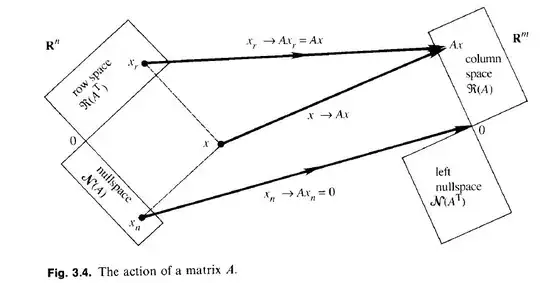

Here is a famous picture after Prof. G. Strang book on Linear Algebra and the link to his video on the "Big Pictures":
https://www.youtube.com/watch?v=ggWYkes-n6E
I hope it can help your insight on this fact as it is for me.

  • I thought a bit about this and I think I see (at least part of) your point. If $A$ is a matrix, it is actually trivial to see why $\text{Ker}(A)$ is orthogonal to the range of $A^$. Taking inspiration from the linked video: the Ker of $A$ is the set of vectors orthogonal to the complex conjugates of (all) the rows of $A$. But the range of $A^$ is exactly the span of those same rows, hence the spaces are trivially orthogonal to each other. It seems so trivial now that the question itself seems silly, at least for the case of finite dimensional operators (that is, matrices). – glS Dec 11 '17 at 15:49
  • I still don't much see why the fact that the ranks of $A$ and $A^*$ are the same is relevant though – glS Dec 11 '17 at 15:52
