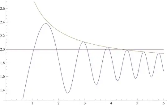

A Contour Integral Estimate
This estimate is valid for all $n\gt0$, and shows that the bound is $2$ for $n\ge4.5$ (since $\sqrt\pi\doteq1.77245385$). The contours in the complex plane are straight lines, and are parametrized linearly. $$ \begin{align} \left|\,\int_{-n}^ne^{iy^2}\,\mathrm{d}y\,\right| &\le\left|\,\int_{-n(1+i)}^{n(1+i)}e^{iy^2}\,\mathrm{d}y\,\right| +\left|\,\int_n^{n(1+i)}e^{iy^2}\,\mathrm{d}y\,\right| +\left|\,\int_{-n(1+i)}^{-n}e^{iy^2}\,\mathrm{d}y\,\right|\\ &\le\sqrt2\int_{-n}^ne^{-2y^2}\,\mathrm{d}y +2\int_0^1e^{-2n^2t}n\,\mathrm{d}t\\[3pt] &\le\sqrt\pi+\frac1n \end{align} $$
This is pretty good
Here is the plot of the actual value of the integral vs the estimate above vs $2$:
Note that the first maximum after $n=4.5$ is the first one that is less than $2$.
