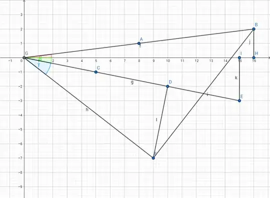

What is the value of : $$\arctan(1/2)+\arctan(1/5)+\arctan(1/8)?$$
I tried to do geometric solution:: enter image description here
Where in the angles we are looking for are shown, but I can't solve it. Can we use it with this kind of approach? Can someone also post a solution using trigonometric identities?

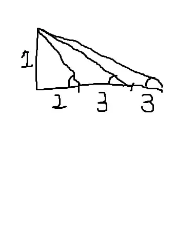

As you mentioned "geometric proof", let me try to provide one: ;)
why is this 45 degree
Hope it helps though...
Hw Chu
  • 5,841
  • [+1] I tried... but I did not succed... Besides have you seen the solution by Jack d'Aurizio ? – Jean Marie Dec 05 '17 at 09:20
    Well yes. Of course to prove this the standard method is those by Jack d'Aurizio and Robert Z, and this "geometric proof" is hard to extend, especially if you do not have standard arguments in mind. Essentially Jack's proof provides a geometric proof as well, with points on the coordinates (0,0), (80, 10), (78, 26) and (65, 65), and what I did is simply an attempt to squeeze everything in smaller coordinates. – Hw Chu Dec 07 '17 at 03:37
