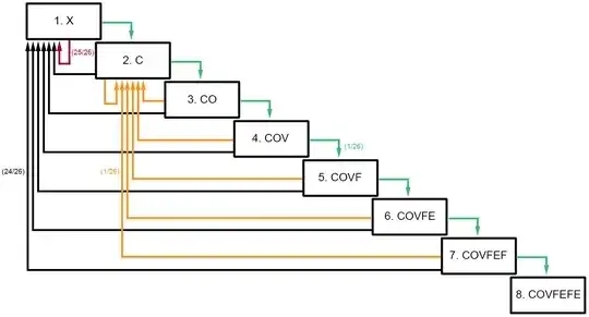

Here is a solution to the COVFEFE problem using a Markov chain. I found this great and easy to understand reference with some background information on Markov Chains from Darthmouth College
The probability to type any letter at any given time is $1/26$. We can create a diagram with the different states the word being typed can be in:
enter image description here The colours represent the probability to move from one state to another. The COVFEFE state, is an absorbing state. Once it is reached, we're done. We need to calculate the expected time (number of steps) to reach this state.
Using the diagram, you can create the $8 \times 8$ transition matrix $\textbf{P}$, where each element $P_{ij}$ represents the probability to go from state $i$ to $j$:
$$\textbf{P} = \begin{pmatrix} \frac{25}{26} & \frac{1}{26} & & & & & & &\\ \frac{24}{26} & \frac{1}{26} & \frac{1}{26} & & & & & &\\ \frac{24}{26} & \frac{1}{26} & & \frac{1}{26} & & & & &\\ \frac{24}{26} & \frac{1}{26} & & & \frac{1}{26} & & & &\\ \frac{24}{26} & \frac{1}{26} & & & & \frac{1}{26} & & &\\ \frac{24}{26} & \frac{1}{26} & & & & & \frac{1}{26} & &\\ \frac{24}{26} & \frac{1}{26} & & & & & & \frac{1}{26} &\\ & & & & & & & 1 &\\ \end{pmatrix}$$
This matrix is in what is called the canonical form:
$$\textbf{P} = \begin{pmatrix} &\textbf{Q} & \textbf{R} \\ &\textbf{0} & \textbf{I}\\ \end{pmatrix}$$
In this case $\textbf{Q}$ is a $7\times7$ matrix of rows and column 1 to 7 (i.e. states 1 to 7), and $\textbf{I}$ is a $1\times1$ identity matrix. See the reference paragraph 11.2 for a more detailed explanation.
From the transition matrix, you can create the fundamental matrix $\textbf{N}$:
$$\textbf{N} = (\textbf{I} - \textbf{Q})^{-1}$$
($\textbf{I}$ of same dimension as $\textbf{Q}$ here)$. \textbf{N}$ has the property that $\textbf{N} = 1 + \textbf{Q} + \textbf{Q}^2 + ...$ i.e. the entry $ij$ is the expected number of times the system is in state $j$ starting from state $i$.
It's not hard to show that the number of steps needed $t_i$ to get from state $i$ to the bound state is given by a vector $\textbf{t}$
$$\textbf{t} = \textbf{N}\textbf{c}$$
See Theorem 11.4 and 11.5 from the reference for the proof.
The tedious bit is actually calculating $\textbf{N}$. It can be done by hand, but I would suggest using Mathematica or something similar instead. Once you have $\textbf{N}$, you find the number of needed steps is $t_1 = 8031810176$, which is about 4% faster than in the 'wrong' answer!
