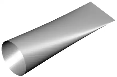

I am faced to a problem where I need to get the parametric equation of the surface generated by 2 curves.
For example, I have the equation of a circle $(x, y, z) = (R\cos(t), R\sin(t), 0)$ and the equation of a line. I want to get the surface between them to have a special cylinder like the photo below :
Special cylinder
Is it possible to compute the parametric equation of this surface ?
Thanks
zoli
  • 20,817
  • It is conoid surface. Have a look to (https://math.stackexchange.com/questions/1985163/calippo-toothpaste-and-milk-packing) – Jean Marie Nov 26 '17 at 12:56
Something like this?
\begin{align} L=6\,R ,\\ S(u,v)&= (R\cos u,\, R\,(1-\tfrac{v}L)\sin u,\,v) ,\quad u\in[0,2\pi],\ v\in[0,L] . \end{align}
